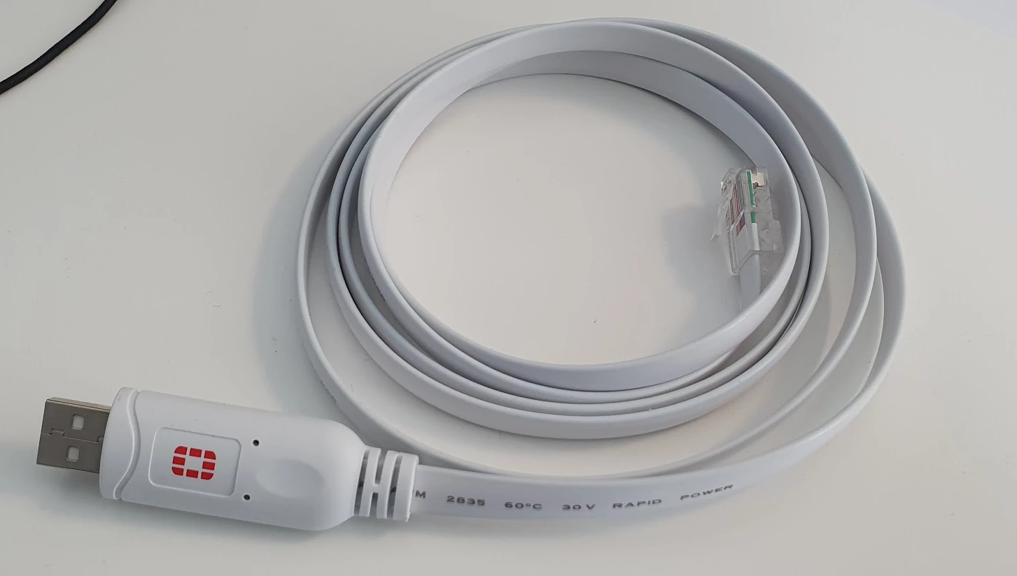

  • On devices without this feature present, like all low-end models, Kernel debugging can only be collected via the console port. See the instructions below for this method.
  1. Connect a computer to the FortiGate console port for long-term monitoring: see Technical Tip: How to connect to the FortiGate console port. When using the PuTTY Windows application, refer to Technical Tip: How to create a log file of a session using PuTTY for more information.

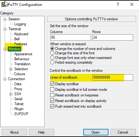

  1. Log all output to a file. With the program PuTTY, change the 'Lines of scrollback' to a high value like for example, 999999999 (Category -> Window -> Lines of scrollback), to view the log file in its entirety.
