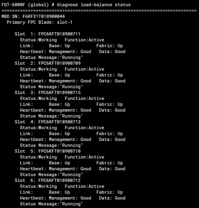

Step 1: Connect to the Management Board (MBD).
Make sure to access the global CLI prompt on the Management Board. The example used here assumes that the FortiGate-6000F chassis has six Fortinet Processor Cards FPCs installed.

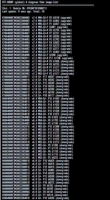

Step 2: Run the diagnostic command.
Use the following command to check the available firmware images from FDS across all modules (MBD and FPCs):
diagnose fdsm image-list
Each FPC and the MBD will list the compatible firmware images retrieved from FDS.
Notes:
  • Ensure the FortiGate-6000F can connect to FortiGuard (FDS) to retrieve the image list.
  • Access permissions or network policies may block the retrieval if not properly configured.
