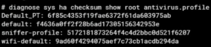

'FGT1':

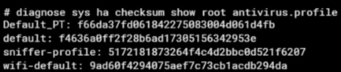

'FGT2':
As shown in the figure above, Default_PT has a different hash value on both the HA peers.
