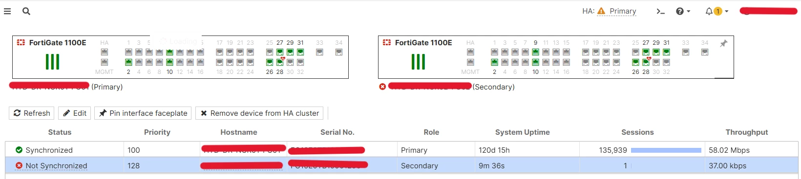

Devices in an HA cluster may become out of sync due to various factors, such as system upgrades, reboots, failovers, or delays in configuration synchronization from the primary to the secondary unit.
One of the cases where the cluster gets out of sync is due to the 'system.central-management' object.

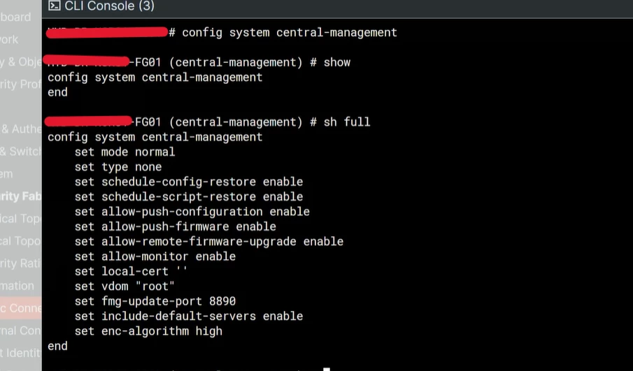

In this scenario, the primary device has the central-management type set to 'none' as shown in the image below.

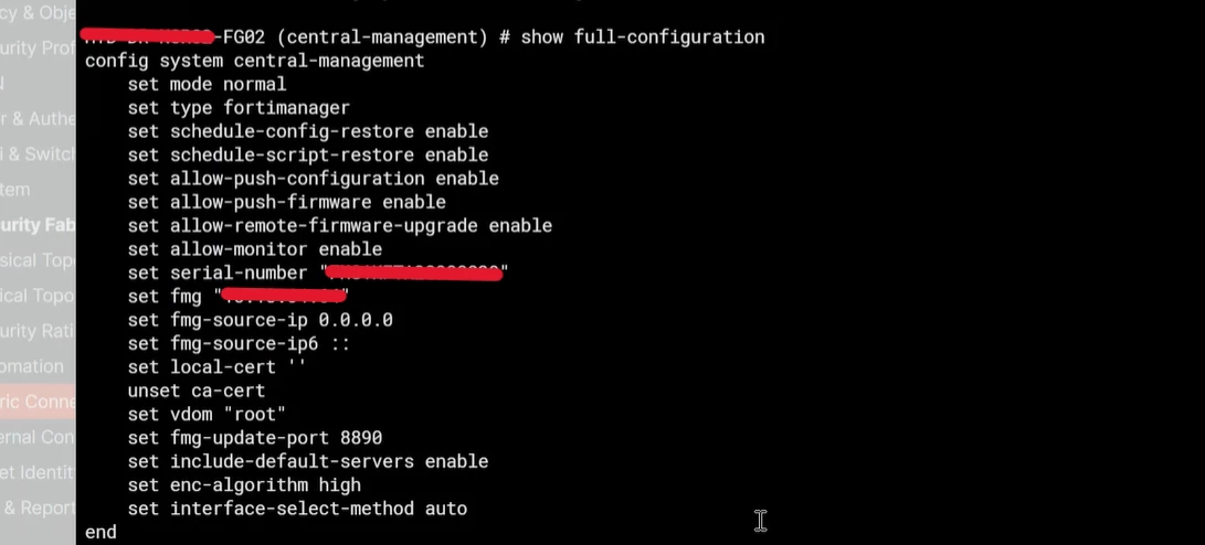

On the secondary device, the central-management type is set to 'FortiManager', with the serial number and FortiManager IP address defined under the 'config system central-management' section.

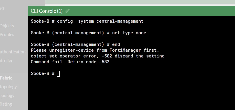

An error may occur when attempting to change the central management type from 'FortiManager' to 'none' as shown in the image below.
