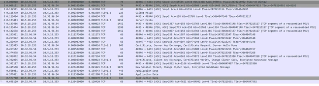

This is the PCAP file of the communication between the FortiToken Mobile user and the FortiGate WAN IP when the user is sending the approved message:
Once the user selects 'Approve' on the FortiToken Mobile the packet will come to the FortiGate WAN IP so the communication between the user phone and the FortiGate should be there. User's phone should be connected to the internet.

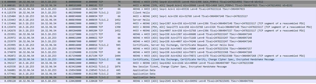

This is the communication between FortiGate and the FortiGuard server to send the push notification to the user's phone:
If the FortiGate is behind another router (NAT), it is required to forward port 4433 on the router to the FortiGate.
