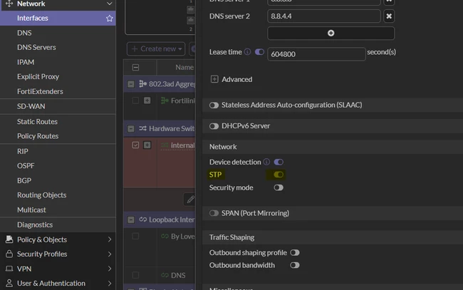

To resolve the issue of FortiSwitches going offline after updating the FortiGate to v7.6.4, v7.6.5, or v7.6.6, enable the Spanning Tree Protocol (STP) setting on the hardware switch FortiLink interface.
From CLI:
config system interface
    edit <FortiLink_hardware_switch_interface>
        set stp enable
From GUI:
After enabling STP, the FortiSwitches should come back online.
If there is no access to FortiGate to configure STP but FortiSwitches are accessible, configure the uplink to FortiGate as a Static ISL trunk as shown in Configuring FortiLink.
