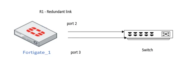

The above topology has two links between the FortiGate and a switch. On the FortiGate, the two links are part of redundant interface R1, and on the switch side, the ports are configured as access ports.
The switch learns the mac address of FortiGate only on the interface connected to port 2 on FortiGate, and not on the interface connected to port 3 on FortiGate, as the interfaces are part of a redundant link.
In this case, port 2 is active and port 3 is in standby or non-active link.
In a rare scenario, if the packet reaches FortiGate on port 3, it will get processed by FortiGate even if the switch does not learn the MAC address of FortiGate on this interface. This can happen if the MAC address table of the switch is full, or if there is a broadcast storm in that VLAN on the switch. This can cause disruption to some applications and traffic. Use the following debug commands for this kind of scenario when the FortiGate processes the packets on a non-active link.
