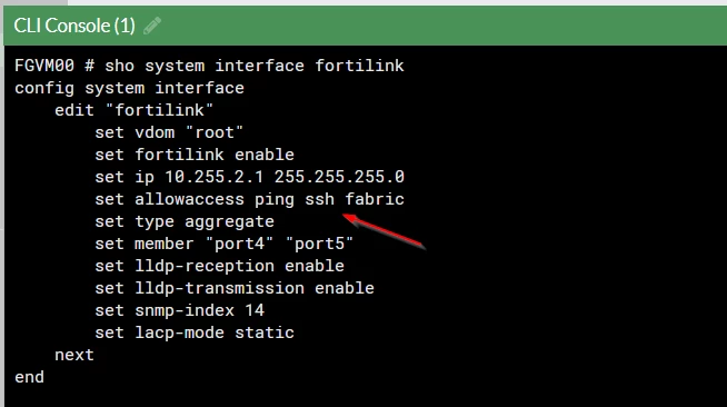

The FortiLink interface in version 7.2.X shows it has administrative access SSH enabled:
Due to a fix for bug ID #870083 in versions 7.4.0 and above, a restriction was introduced so FortiLink interfaces only allow ping and fabric as means of administrative access (set allowaccess ping fabric). Since the FortiLink interface has other administrative access than these two, is not migrated during the firmware upgrade and the references are removed.

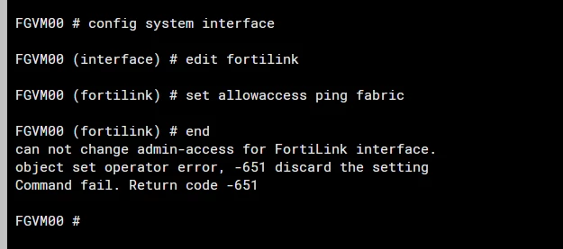

To allow the interface to be migrated during the upgrade, SSH access must be removed from the interface. However, this cannot be completed in the GUI or CLI:
To fix this error, there are two options. The first one is removing all the FortiLink interface references in the configuration, disabling the FortiLink option in the interface, and then setting the administrative access to ping and fabric. After, FortiLink must be enabled and all of the references will be added again. This can be a long/complex job depending on the configuration.

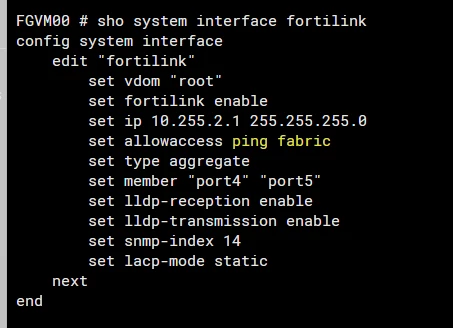

The second option is to perform a configuration backup , edit the file, and remove the SSH access from the FortiLink interface. After, the modified configuration file must be restored on the FortiGate. After this, the FortiLink interface will only show ping and fabric as administrative access:
