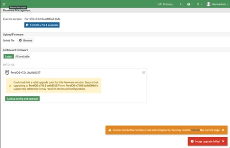

This article describes how to handle the error 'Image upgrade failed' that occurs while upgrading the FortiGate from GUI.
FortiGate.
Try one of the subsequent options:
  1. Clear the browser cache and cookies.
  2. Try another browser.
  3. Use incognito mode.
  4. Verify if FortiGuard is connected so the firmware can be downloaded.
If it fails, either fix the FortiGuard connectivity or try to download the image from SupportSupport -> Firmware download -> Download.
Then upload the Firmware image to FortiGate by following the steps outlined in Technical Tip: How to manually download Firmware of FortiGate and how to upload it on FortiGate.
