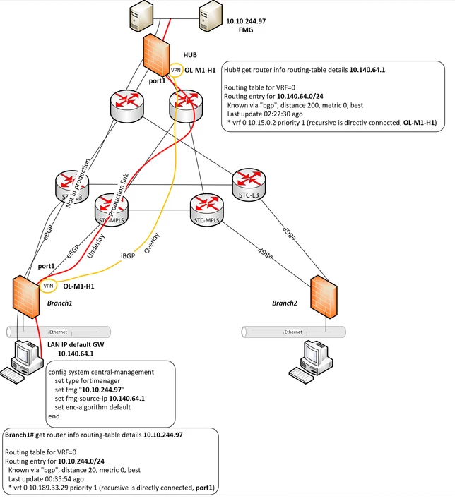

Branch1 #  id=65308 trace_id=111 func=print_pkt_detail line=5870 msg="vd-root:0 received a packet(proto=1, 10.10.244.97:6707->10.140.64.1:2048) tun_id=10.1 82.90.1 from OL-M1-H1. type=8, code=0, id=6707, seq=0." id=65308 trace_id=111 func=init_ip_session_common line=6055 msg="allocate a new session-00001685" id=65308 trace_id=111 func=ip_route_input_slow line=1696 msg="reverse path check fail, drop"
In this setup, there are two branch FortiGates and one Hub, all configured with SD-WAN.
As shown in the diagram, the FortiGate (Branch1) is configured to use the LAN interface IP (10.140.64.1) as the source address for communication with FortiManager.
The LAN subnet is advertised via BGP to all participating peers—eBGP on the underlay and iBGP on the overlay.
In this scenario, traffic destined for FortiManager is preferred via the underlay. However, since the configuration specifies a source IP that is expected to be routed through the overlay, the traffic fails the Reverse Path Forwarding (RPF) check, as it is essentially considered spoofed.
Analysis:
As shown, the traffic is going out through the underlay (port1):
Branch1 # diagnose sniffer packet any "host 10.10.244.97" 4 0 l Using Original Sniffing Mode interfaces=[any] filters=[host 10.10.244.97] 2025-03-18 17:36:08.830226 port1 out 10.140.64.1.3377 -> 10.10.244.97.541: syn 1622954178 2025-03-18 17:37:32.326987 port1 out 10.140.64.1.6723 -> 10.10.244.97.541: syn 1659305991 2025-03-18 17:37:33.390237 port1 out 10.140.64.1.6723 -> 10.10.244.97.541: syn 1659305991 2025-03-18 17:37:35.470194 port1 out 10.140.64.1.6723 -> 10.10.244.97.541: syn 1659305991
Resolution:
Removing the fmg-source-ip or configuring the appropriate IP will solve the problem.
Branch1 (central-management) # show config system central-management set type fortimanager set fmg "10.10.244.97" set fmg-source-ip 10.140.64.1 set enc-algorithm default end  Branch1 (central-management) # unset fmg-source-ip  Branch1 (central-management) # end  Branch1 #  id=65308 trace_id=115 func=print_pkt_detail line=5870 msg="vd-root:0 received a packet(proto=6, 10.10.244.97:541->10.189.33.30:7210) tun_id=0.0.0.0 from port1. flag [S.], seq 399929127, ack 342692521, win 64240" id=65308 trace_id=115 func=resolve_ip_tuple_fast line=5958 msg="Find an existing session, id-00004a9b, reply direction" id=65308 trace_id=115 func=__vf_ip_route_input_rcu line=1991 msg="find a route: flag=80000000 gw-0.0.0.0 via root" id=65308 trace_id=116 func=print_pkt_detail line=5870 msg="vd-root:0 received a packet(proto=6, 10.10.244.97:541->10.189.33.30:7210) tun_id=0.0.0.0 from port1. flag [.], seq 399929128, ack 342693500, win 63" id=65308 trace_id=116 func=resolve_ip_tuple_fast line=5958 msg="Find an existing session, id-00004a9b, reply direction"
Enabling the asym-routing or turning off the RPF check under the interface settings, will not solve this problem.
