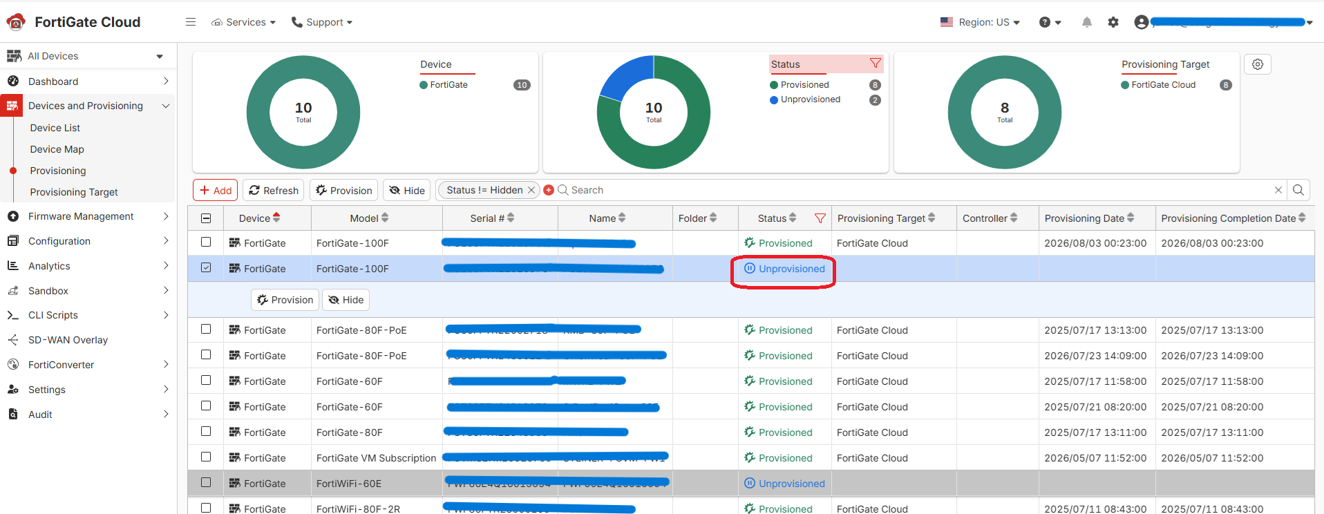

Root cause:
Only the primary is provisioned to the FortiGate Cloud account. The secondary is not.
For an HA pair, FortiGate Cloud requires that all cluster members are provisioned to the same FortiGate Cloud account before activation is performed on the primary unit. When activation runs on the primary while the secondary is missing from the account, the backend detects an incomplete cluster record and instructs the unit to revert to local management.
In the FortiGate Cloud portal, check under Provisioning whether both the primary and secondary serials are listed under the same account. In this scenario, only the primary appears.
Go to Provisioning, select the secondary unit, and select Provision. Confirm both serials are listed under the same FortiCloud account.
FortiGate devices can be also be provisioned using a FortiCloud Key and FortiCloud Inventory. Refer toCloud provisioning for more details.
The FortiCloud key can only be added once. If the key added previously was deleted, it cannot be re-used or re-added.
To fix the issue, open a FortiCare Ticket with the 'Customer Service' type to request to re-generate the FortiCloud key. Refer to Customer Service Tip: How to create a ticket for Fortinet TAC.
Once both members are provisioned, re-activate FortiGate Cloud.
