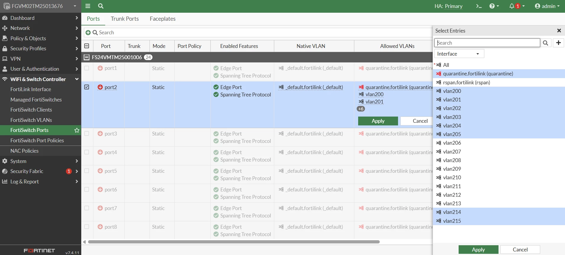

After upgrading to FortiOS 7.4.9 and later 7.4.x builds (including 7.4.11), administrators may experience an issue when configuring Allowed VLANs on FortiSwitch ports via the FortiGate GUI.
When editing a FortiSwitch port, some VLAN entries fail to fully load in the GUI. These VLANs appear unchecked, even though they are correctly configured on the port.
In FortiOS 7.4.9-7.4.11, when an administrator performs the following steps, several VLANs that were previously selected will appear unchecked:
  1. Logs in to the FortiGate GUI.
  2. Navigates to WiFi & Switch Controller -> FortiSwitch Ports.
  3. Edits a switch port under Allowed VLANs.

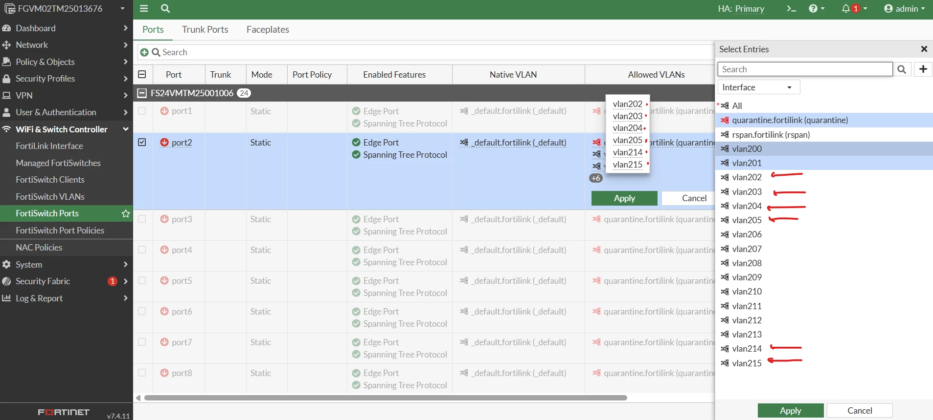

  1. If Apply is selected:
  • Only the VLANs currently visible and checked in the GUI are saved.
  • Missing VLANs are removed from the port configuration, which can cause a traffic disruption.
  1. If the administrator edits the allowed Allowed VLANs a second time, all previously selected VLANs will be visible as expected.
Recommended actions:
  • This behavior is not reproducible in 7.6.6, which is the current recommended release. See Technical Tip: Recommended release for FortiOS.
  • If the issue remains on 7.4.x:
    • Use the CLI where possible.
    • If the GUI is used, double-check selected VLANs before applying changes.
