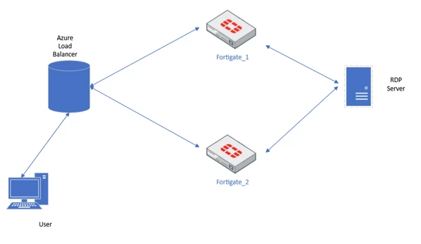

Description The article describes the behavior of the Azure load balancer and how it affects sessions on a FortiGate cluster.
Scope All FortiGate VMs on Azure behind load balancer.
During an ongoing RDP session, both FortiGates have sessions for the traffic between the User VM and to RDP server. In this example, fortigate_1 is handling the session between the user and the RDP server. When Fortigate_1 is rebooted, ILB switches the traffic to the second FortiGate after the default probe fail timer of 5 seconds. However, the session is not picked up by fortigate_2 and instead, a new session is created on fortigate_2.

This is a known issue for the Azure load balancer. Even though a health probe failed, it will not re-route the existing sessions.
This is by design, intended to offer the administrator the opportunity to gracefully shut down the application to avoid any unexpected and sudden termination of the ongoing application workflow.
Note: The above example is for an A-A cluster behind ELB, however, this is an expected behavior for any kind of cluster (A-A, A-P)/standalone setup behind an Azure load balancer.
