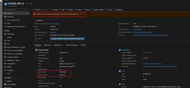

Occasionally, the Microsoft Azure portal states that the virtual machine agent is not ready and requests troubleshooting the issue:
When this issue occurs, it usually indicates a problem with connecting to the Azure Fabric Controller (168.63.129.16).

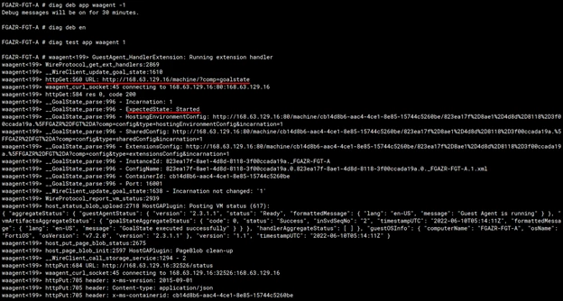

  1. To check the connectivity between the FortiGate virtual machine agent and Azure Fabric Controller, run the following command:
diag deb app waagent -1
diag deb console timestamp enable
diag deb en
diag test app waagent 1
Note that the virtual agent is trying to connect to Azure Fabric Controller IP 168.63.129.16 and the connection did not manage to go through.

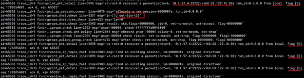

  1. Run the debug flow to check on the traffic flow:
    diag deb flow filter addr 168.63.129.16
    diag deb flow sh function-name en
    diag deb flow sh iprope en
    diag deb flow trace start 10000
    diag deb en
    From the debug flow above, it is possible to see that the traffic towards the Azure Fabric Controller is being forwarded to port2 which is supposed to be meant for the internal network traffic.

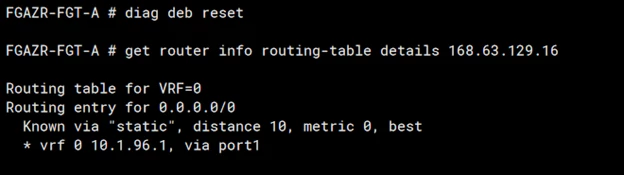

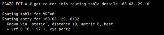

  2. Check the routing table for 168.63.129.16 with the following command:
get router info routing-table details 168.63.129.16
Note that there is a static route configured to route traffic destined to 168.63.129.16/32 to port2.
  1. The Azure Fabric Controller IP is considered an external IP from FortiGate's point of view.
     As a result, the traffic should be exiting using port1 instead of port2.
    In the above scenario, removing the static route and re-initiating waagent connection will resolve the issue.

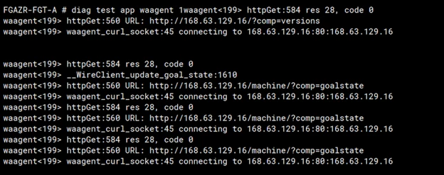

    Recheck the connection with the following commands, which should show that waagent is communicating successfully with Azure Fabric Controller:
    diag deb reset
    diag deb en

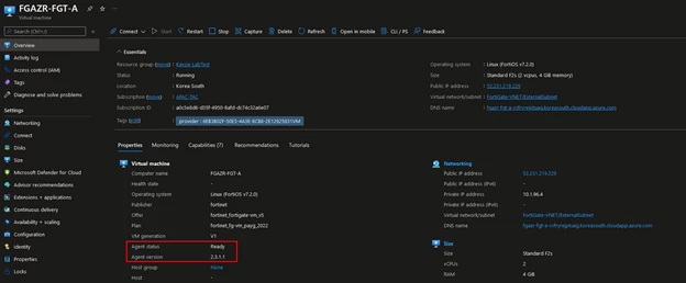

  2. Once the waagent is able to send the traffic towards the correct interface, the agent status and host details will appear in the Azure console respectively:
    The connection between the Microsoft Azure Agent and Azure Fabric controller will not impact FortiGate performance.
    There is no downtime required to perform the above remediation steps.
