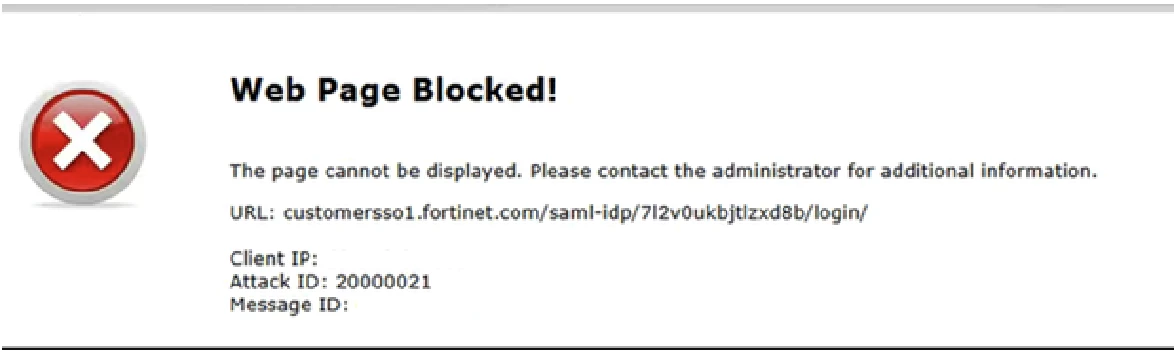

As a result, any attempt to use FortiCloud SSO to log in to a FortiGate running a vulnerable firmware version triggers the blocking mechanism, displaying the error:
This is a deliberate security measure enforced by Fortinet on the cloud side, not a local FortiGate block or user-side issue.
Upgrading the FortiGate to a fixed firmware version resolves the issue and restores access.
