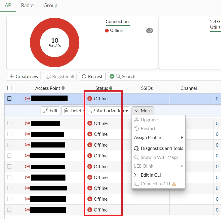

  1. On WiFi & Switch Controller -> Managed FortiAP's, all managed APs show as offline:

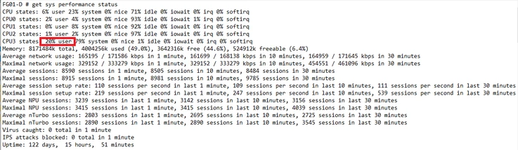

  1. Verifying system performance with the command below shows one of the CPU cores with no idle cycles with all going to system/user space.
FG01-D # get system performance status

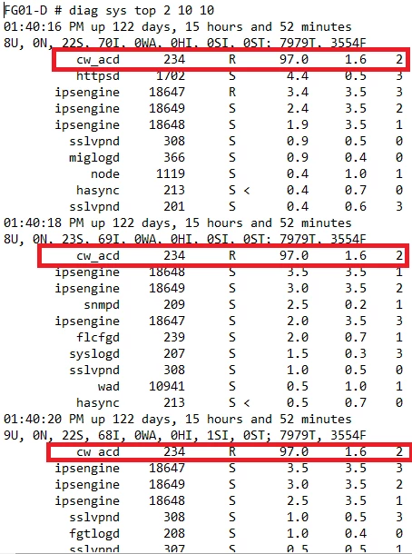

  1. When running 'diagnose system top'  shows the daemon ('cw_acd') responsible for handling communication with the fortiAP's consuming large amounts of CPU cycles:
