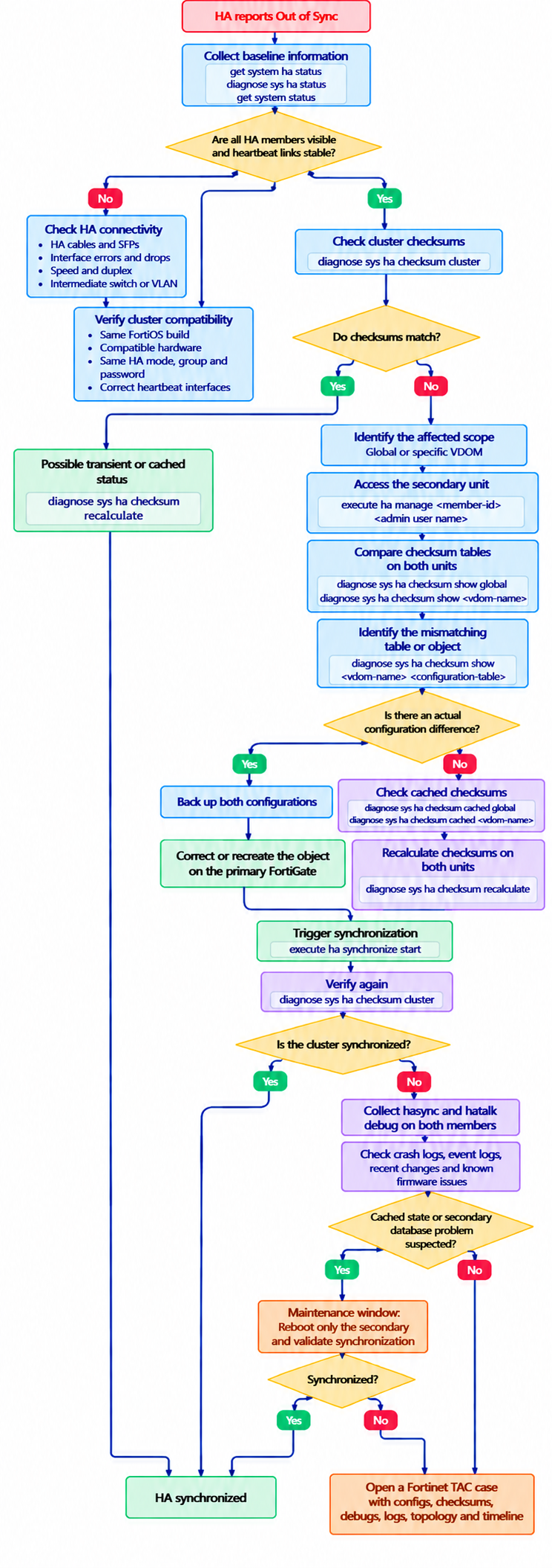

Troubleshooting Tip: Flow diagram for HA synchronization in FortiGate
This article provides a systematic troubleshooting flow diagram for identifying and resolving HA out-of-sync issues on FortiGate devices.
FortiGate.
Troubleshooting flow - HA Out of Sync:
