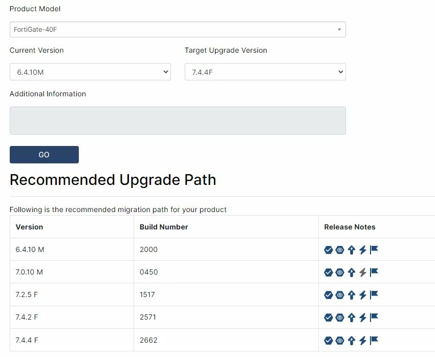

Let's consider a firewall 40F is running on 6.4.10 and the target firmware is 7.4.4.
If checking in the upgrade path tool (Upgrade Tool), the path is:
Now if someone jumps directly from 6.4.10 to 7.4.4 skipping the other version, the firewall may not come up properly.
