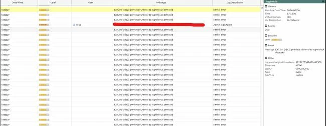

The following error may be observed in the console or events:
previous I/O error to superblock detected

  1. Check the system event logs, and the following logs may appear:
"date=2025-04-14 time=14:17:56 id=759817687336199053 itime="2026-01-22 14:24:12" euid=3 epid=3 dsteuid=3 dstepid=3 logver=704076595 logid=0100020010 type="event" subtype="system" level="critical" msg="EXT2-fs (sda1): previous I/O error to superblock detected" logdesc="Kernel error" eventtime=1769088757646884917 tz="+0100" devid="FG4H0XXXXXX" vd="root" dtime="2025-04-14 12:14:46" itime_t=1768767552 devname="TEST""
