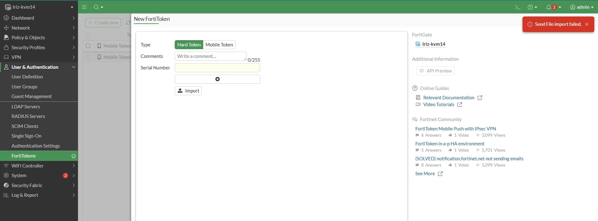

When attempting to import a physical FortiToken seed file into a FortiGate device, FortiGate may display the error message 'Seed Import Failed'.
This error does not indicate a problem with the token file. Instead, it is caused by a bug in the web-based management interface(GUI).

Workaround:
Manually add the serial number of the Hardware token to import instead importing from file.
  1. Navigate to the FortiTokens Section , go to User & Authentication -> FortiTokens.
  2. Set the Type to Hard Token.
  3. Manually enter the FortiToken serial number in the Serial numbers field.
  4. Select OK to add the token.
Alternative workaround: Import the token seed via FTP or TFTP instead of GUI:
execute fortitoken import ftp <file name> <ftp server>[:ftp port] <Enter>|<user> <passwd>
Or:
execute fortitoken import tftp <file name> <tftp server>
After importing, the command 'get user fortitoken' can be used to verify token status.
