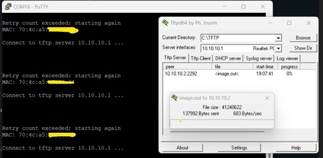

Description This article describes how to troubleshoot the error 'Retry count exceeded; starting again' when formatting and loading a FortiGate firmware image using TFTP.
Scope FortiGate.
When uploading the firmware using TFTP, there may be an issue with the TFTP server to the firewall connectivity, where the following error can be seen.
To address the 'retry count exceeded' issue during a TFTP transfer, follow these steps:

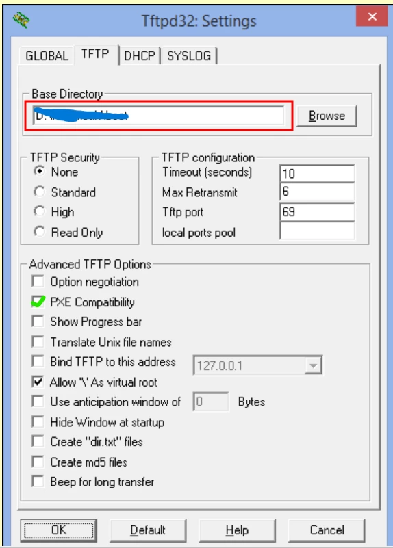

  5. Disable the Windows firewall.
  6. Verify the TFTPD settings & enable the 'PXE Compatibility' checkbox as below.
  7. Incorrect TFTP Filename or Path.
  8. Slow or Unstable Network Connection.
  9. Security Software Blocking the Transfer.
  10. Verify if any other Ethernet port on the PC is configured with the same subnet as the TFTP server. If so, either disable that Ethernet port or change the TFTP server to a different subnet.
