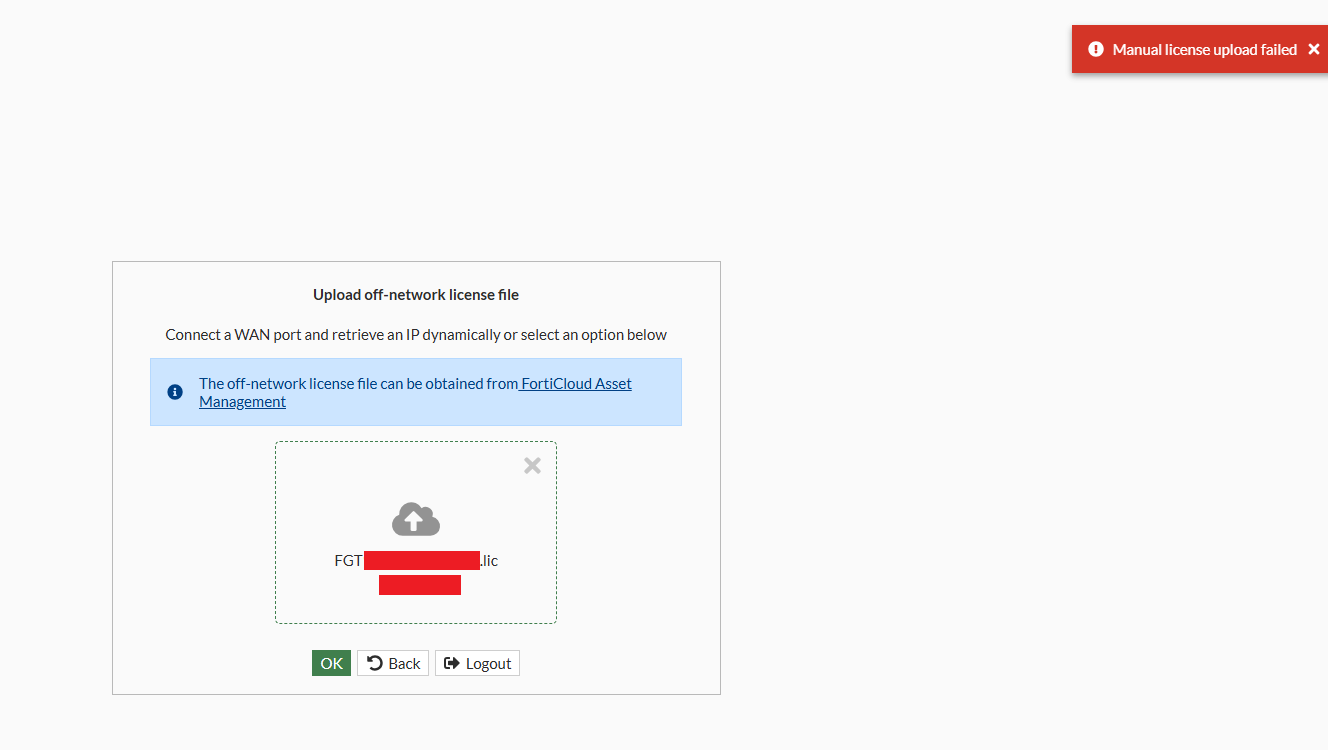

When trying to activate the license on FortiGate, the process might fail due to the error 'Manual license upload failed', as shown below:

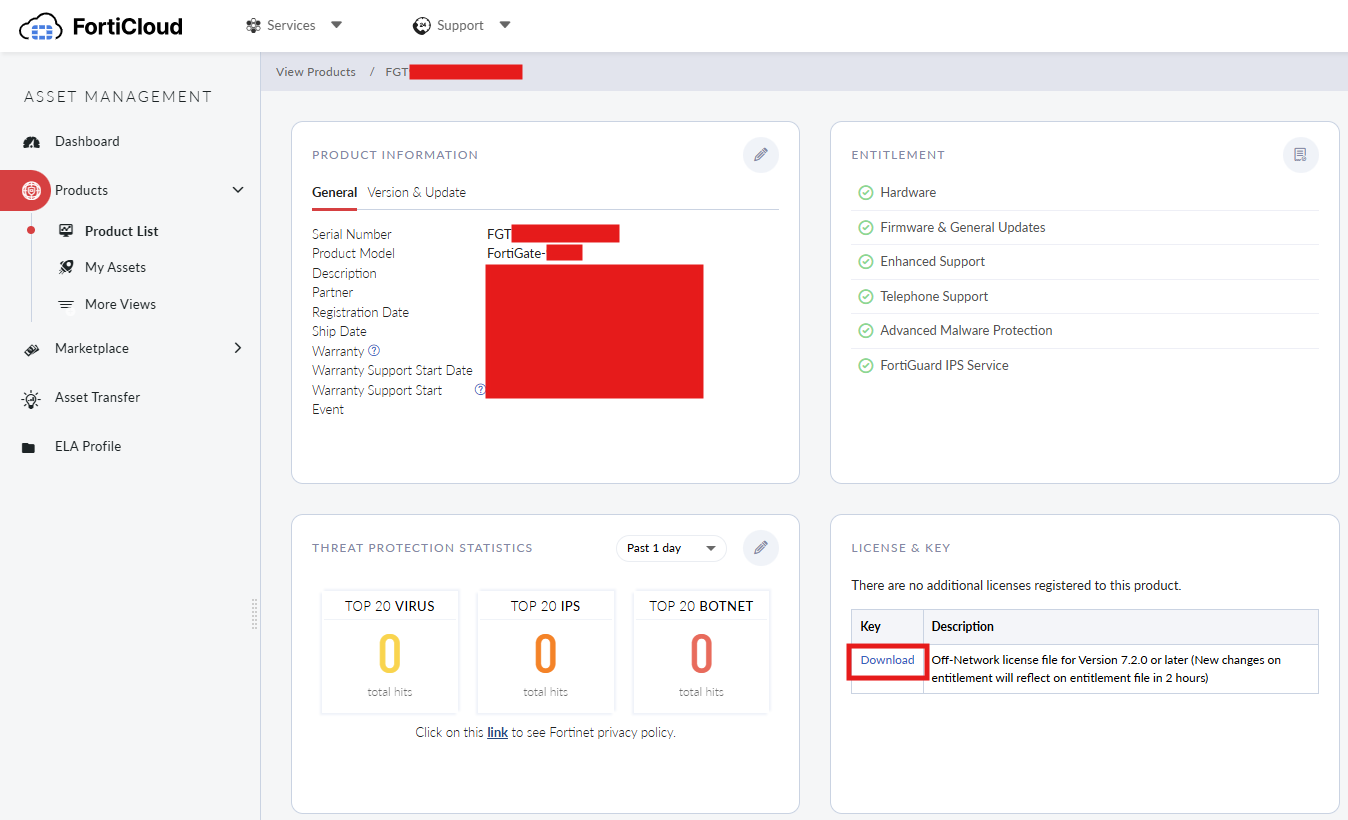

Usually, this issue occurs when the license is downloaded in less than 1 hour after the FortiGate has been registered in FortiCloud Asset Management. To fix the issue, wait around 4 hours after registering the FortiGate and then download the license again from FortiCloud Asset Management after going to 'Product' -> 'Product List', searching with the FortiGate Serial Number, and selecting 'Download' under 'LICENSE & KEY':
After downloading the license again, upload it in the same way as before and the license should be uploaded successfully.
