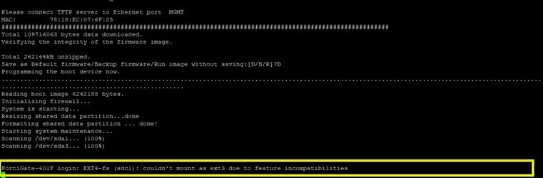

Description This article describes the error 'Partition Image EXT4-fs (sdaX): couldn't mount as ext3 due to feature incompatibilities' during reboot which can appear in the console or with the CLI command 'diagnose sys flash list'
Scope FortiOS 7.4.8+.
The console output of the error appears as follows:
The error 'Partition Image EXT4-fs (sdaX): couldn't mount as ext3 due to feature incompatibilities' not only appears in the console logs, but also shows in a CLI session:
