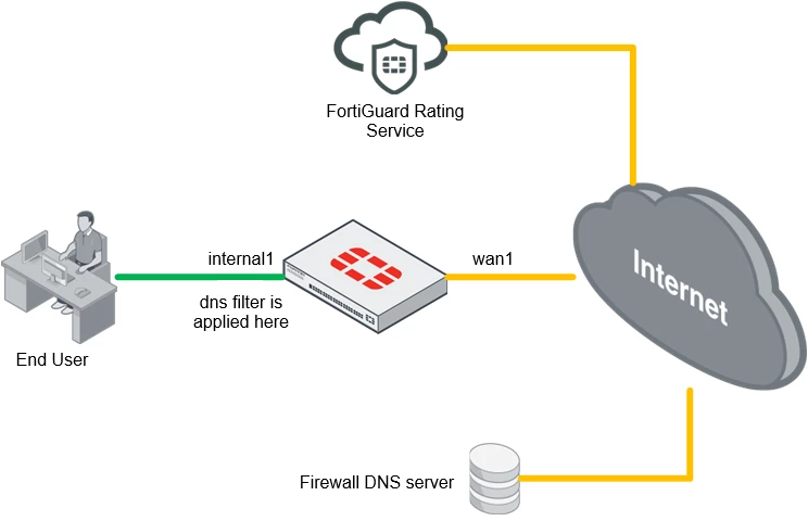

  • End Users use FortiGate as a DNS server.
  • FortiGate is configured to listen for DNS queries on interface internal1, where a DNS filter is applied.

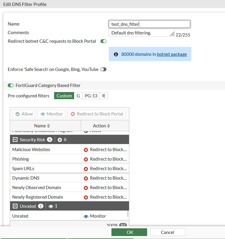

DNS filters can also be applied to firewall policies.
This means that FortiGate checks the categories of the DNS queries with FortiGuard. The default DNS filter profile (as well as any newly created DNS filter profile) is configured to redirect any DNS query that is categorized as as 'Security Risk' to the block portal.
Default action for categories under "Security Risk" is "Redirect to Block Portal"Default action for categories under "Security Risk" is "Redirect to Block Portal"

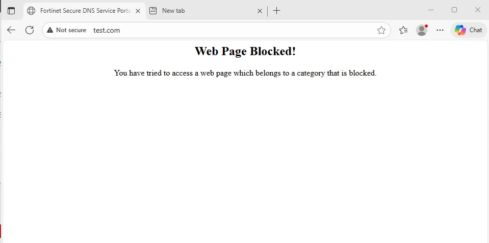

In this example, the action for the Domain Parking category is set to Redirect to Block Portal. If the end user tries to reach a website that is categorized as Domain Parking, it gets blocked.
Example of a Block pageExample of a Block page
