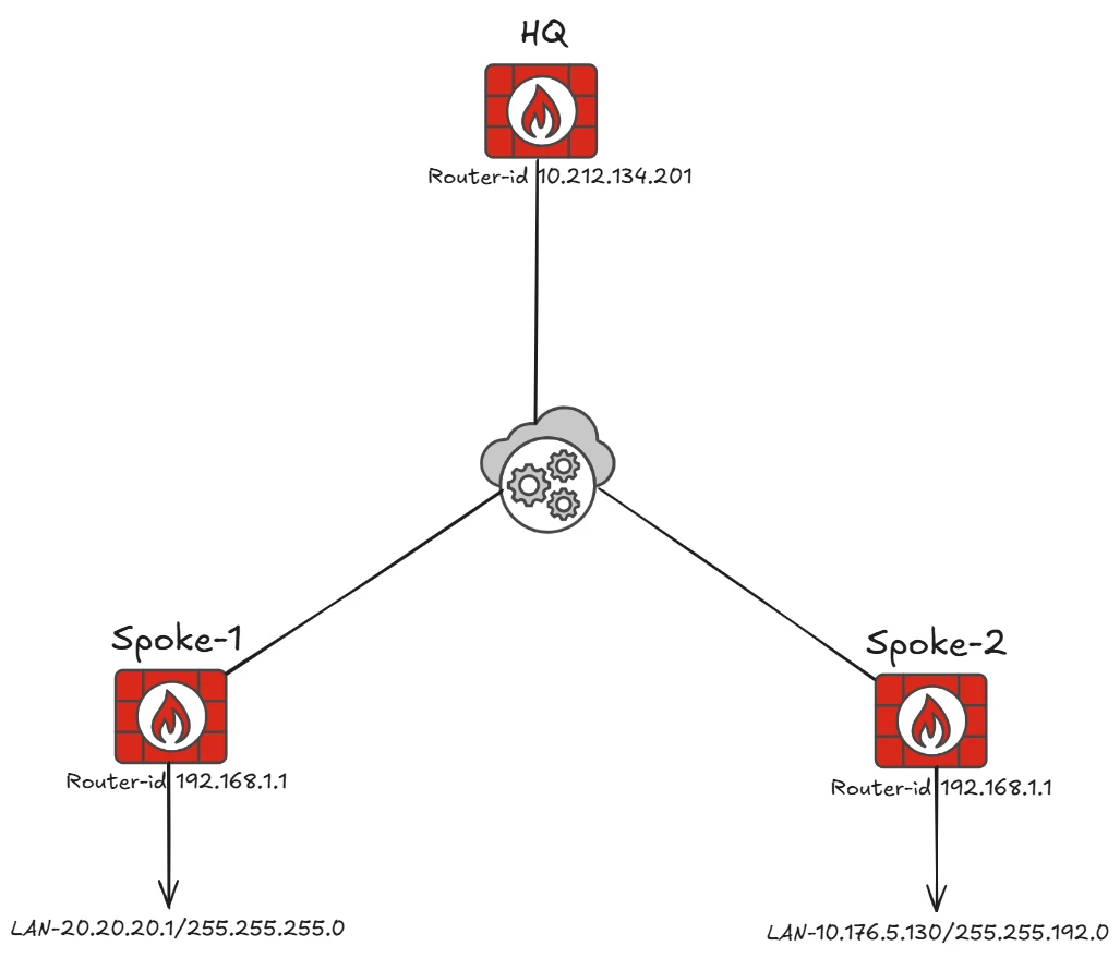

Description This article describes a scenario in which a BGP route is received on Spoke-2 from Spoke-1 but is not installed in the BGP network table or routing table because the BGP router ID is duplicated between the spokes.
Scope FortiGate.
In the network topology shown below, two spokes are connected to a hub using iBGP:
Spoke-1 is advertising 20.20.20.1/24 to the HUB:
SPK_1 # get router info bgp neighbors 10.10.1.1 advertised-routes VRF 0 BGP table version is 6, local router ID is 192.168.1.1 Status codes: s suppressed, d damped, h history, * valid, > best, i - internal Origin codes: i - IGP, e - EGP, ? - incomplete     Network          Next Hop            Metric     LocPrf Weight RouteTag Path *>i20.20.20.0/24    10.10.1.3                     100  32768        0 i <-/->  Total number of prefixes 1
On the hub, the route is received from Spoke-1 and then advertised to Spoke-2:
HUB # get router info bgp neighbors 10.10.1.3 received-routes VRF 0 BGP table version is 16, local router ID is 10.212.134.201 Status codes: s suppressed, d damped, h history, * valid, > best, i - internal Origin codes: i - IGP, e - EGP, ? - incomplete     Network          Next Hop            Metric     LocPrf Weight RouteTag Path *>i20.20.20.0/24    10.10.1.3                     100      0        0 i <-/->  Total number of prefixes 1   HUB # get router info bgp neighbors 10.10.1.2 advertised-routes  VRF 0 BGP table version is 16, local router ID is 10.212.134.201 Status codes: s suppressed, d damped, h history, * valid, > best, i - internal Origin codes: i - IGP, e - EGP, ? - incomplete     Network          Next Hop            Metric     LocPrf Weight RouteTag Path *>i20.20.20.0/24    10.10.1.3                     100      0        0 i <-/->  Total number of prefixes 1
On Spoke-2, the route is received from the HUB but is not being installed in the BGP Table:
SPK_2 # get router info bgp neighbors 10.10.1.1 received-routes VRF 0 BGP table version is 5, local router ID is 192.168.1.1 Status codes: s suppressed, d damped, h history, * valid, > best, i - internal Origin codes: i - IGP, e - EGP, ? - incomplete     Network          Next Hop            Metric     LocPrf Weight RouteTag Path *>i1.1.1.1/32       10.10.1.1                     100      0        0 i <0/0> *>i10.100.0.0/18    10.10.1.1                     100      0        0 i <0/0> *>i20.20.20.0/24    10.10.1.3                     100      0        0 i <0/0>  Total number of prefixes 3
Note: If soft reconfiguration is not enabled, received-routes will show no results. This is expected, see this article: Technical Tip : BGP Routing process when 'Soft Reconfiguration' is enabled.
SPK_2 # get router info bgp neighbors 10.10.1.1 received-routes  % Inbound soft reconfiguration not enabled % No prefix for neighbor 10.10.1.1
The 20.20.20.1/24 network is not present in the BGP table:

The issue occurs because Spoke-1 and Spoke-2 are configured with the same router ID. To resolve the issue, change the router ID on either spoke to a unique value. Note that if no router-id is configured, FortiOS will use the assigned IP address of an existing interface. If spoke devices use the same IP addresses for local interfaces, this issue will be encountered with higher frequency. The router-id selection process is described here: Technical Tip: BGP router-id selection criteria on FortiGate.
Warning: Changing router-id restarts all BGP neighborships on the affected spoke and may cause network disruption for affected BGP networks while the peers re-establish.
