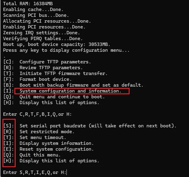

FortiGates with BIOS version 6.000105 and 6.000106 do not have the option of Security Level 0. In this case, upgrading or downgrading does not work. In such cases, the image to be imported using TFTP interrupts the boot process and loads the configuration from the previous version. More information about importing an image using TFTP: Technical Tip: Formatting and loading FortiGate firmware image using TFTP.

Some units, such as FortiGate 50G, 70G, 90G, 120G, and 200G, and their variants, have a 'Signed Firmware Hardware Switch' that requires physical access to change the BIOS security level (info on how to change it can be found on Technical Tip: How to change BIOS security level on FortiGate G series). If BIOS security level does not appear as an option for a physical device, see the product's datasheet to verify if a device includes this feature.
