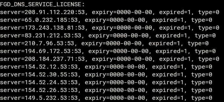

  1. Verify license validity and the connection between FortiGate and the SDNS server :
  • Run the command below to verify the FortiGuard SDNS server.
diagnose test application dnsproxy 3
  • From the output of the above command, check the FGD_DNS_SERVICE_LICENSE line. The SDNS server IP address might be different depending on the location.
In this example, it is:
For this server:
Server IP: 208.91.112.220:53
Expiry Date: 0000-00-00 <----- This indicates an invalid or unspecified expiry date.
Expired Flag: expired=1 <----- This means the license has expired.
Type: type=0 <----- The type of license, specific to Fortinet's classification, but 0 might indicate an invalid or unclassified type.
Check the expiry date under the LICENSE line and make sure it has not expired.

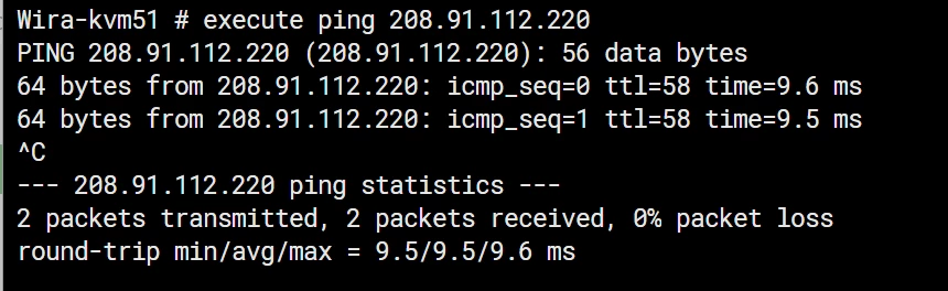

Verify the communication between the FortiGate and the SDNS server.
Make sure the license is valid and not expired. The parameter 'expired' reflects the license status. 0 means that the license is valid, and 1 means that the license is invalid.

execute ping 208.91.112.220
If VDOM is enabled, run the command under the management VDOM.

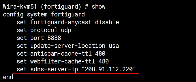

  1. Modify the FortiGuard setting through the CLI console:
config system fortiguard
    set fortiguard-anycast disable
    set protocol udp
    set port 8888
    set sdns-server-ip 208.91.112.220 173.243.140.53 210.7.96.53
The North American server should work in most cases.
However, it is possible to switch to the European server (IP address: 194.69.172.53) to see if it improves latency.

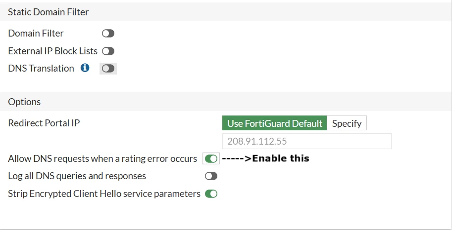

Workaround:

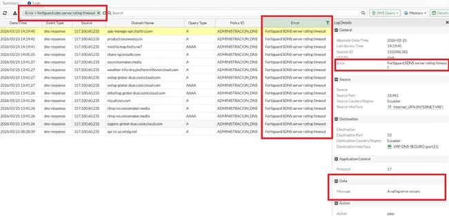

If the security event in the DNS filter shows the message Rating error occurs, Allow DNS requests when a rating error occurs can be used as a workaround.
Note: Enabling this option allows all domains when FortiGuard DNS servers fail due to any connectivity issue with FortiGuard servers, so use this option with caution, as this also provides access to the blocked categories in the selected DNS filter profile.
In the GUI:
In the CLI:
