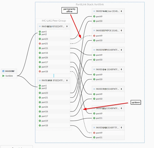

This article describes how to handle connections that are down/flapping between FortiGate and MCLAG FortiSwitches after upgrading the switches.
Scope FortiGate, FortiSwitches.
When FortiGate and FortiSwitches are connected and set up with MCLAG switches, after upgrading FortiSwitches, the connection status in the FortiGate GUI shows as down or flapping.

Solution:
FortiSwitches in MC-LAG need to be on the exact same firmware. Fortinet recommends upgrading the switches at the same time. This can be done by following Switch and WiFi Controller -> Managed FortiSwitches, then pressing shift, and selecting two switches. After, select Upgrade on them.
