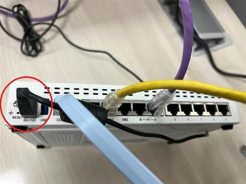

  1. Check the Power Source:
  • Ensure that the power outlet is functional. Plug another device into the same outlet to verify.
  • Confirm that the power cable is securely connected to both the power source and the FortiGate device.

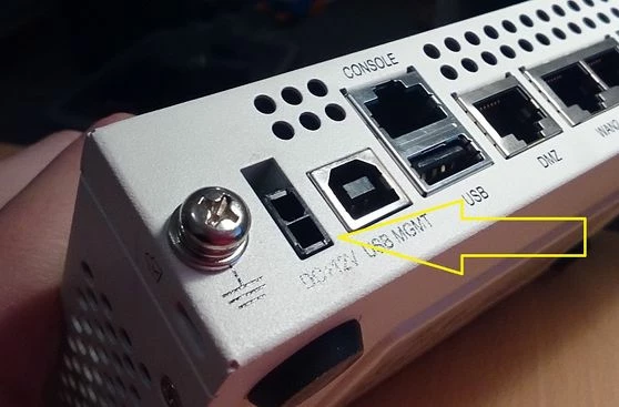

  1. Inspect the Power Cable and Adapter:
Look for any visible damage to the power cable or adapter. If possible, replace it with a known working unit.

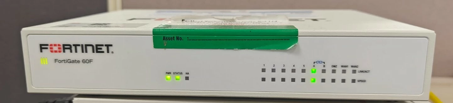

  1. Check for Power LED Indicators:
Observe the Power LED indicators on the firewall. If no lights are visible, the unit might not be receiving power.
The following photo shows the LED status when the firewall is powered up and fully functional:

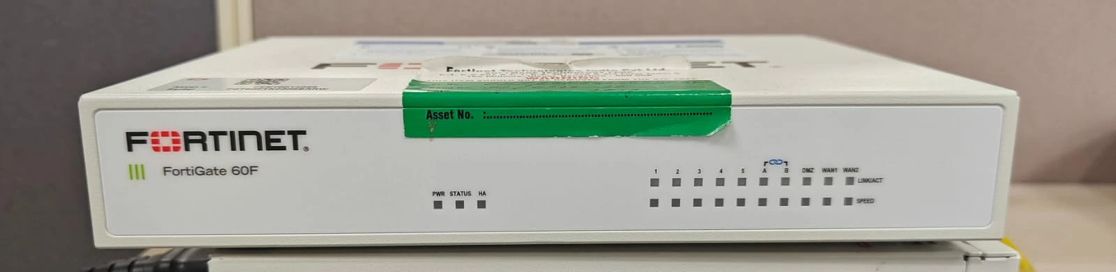

The following photo shows the LED status when the firewall is not functioning:
