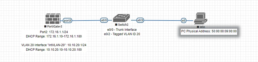

Diagram:
FortiGate is configured as DHCP Server Physical Interface 'port2' and VLAN interface 'IntVLAN-20' with VLAN ID of 20.
FortiGate's Interfaces:

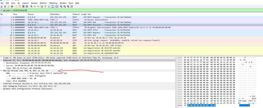

  1. Open the pcap file VLAN20-PCAP.pcap and set the filter as the Physical address of the PC. Example filter: eth.addr == 50:00:00:09:00:00
 It shows on the image the DHCP Messages. More importantly, the DHCP Discovery sent by the PC with transaction ID 0x79543bd
Another filter related to transaction ID can also be added: bootp.id == 0x79543bd
The image above shows the VLAN tag ID 20 on the DHCP Messages. This tag should be visible on the DHCP Messages so that the FortiGate could provide an IP address that is configured on the DHCP Server for VLAN 20.

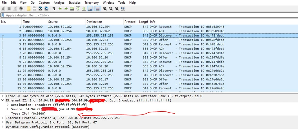

Below is another example if the DHCP Messages being untagged. FortiGate will provide an IP address within the range of the DHCP Server in the Physical Interface instead.
The image below is not related to the network setup for the DHCP Messages that have a VLAN tagging:
