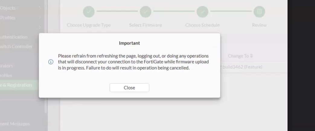

Attempting to upgrade FortiGate firmware from v7.6.1 to v7.6.2 or from v7.6.2 to v7.6.3 triggers an Important warning message: 'Please refrain from refreshing the page, logging out, or doing any operations that will disconnect your connection to the FortiGate while firmware upload is in progress. Failure to do will result in operation being cancelled'.

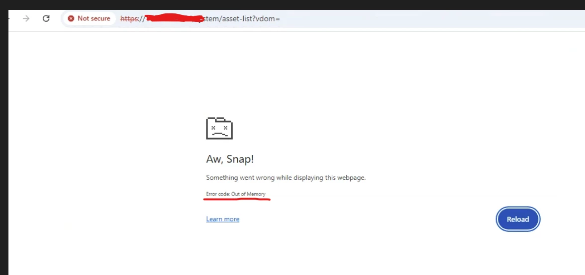

After closing the pop-up, just before the reboot process begins, the browser window crashes with an 'Error code: Out of Memory' message.
Testing with both Google Chrome and Microsoft Edge, including in incognito mode, results in the same browser crash and out-of-memory error. Firefox does not appear to exhibit this behavior; thus, if available could be used instead to perform the firmware upgrade.
