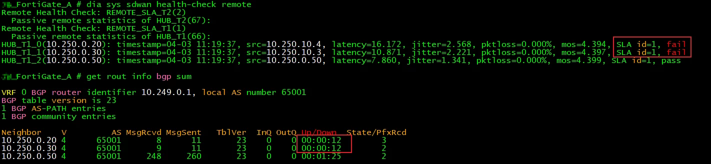

When BGP passive mode is disabled on the ADVPN hub FortiGate, SD-WAN health-check events can trigger repeated BGP session resets.

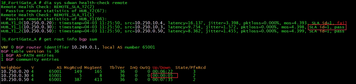

When a health check exceeds the configured Service Level Agreement thresholds, the hub resets the BGP session. Check from the hub side with the following commands:
diagnose system sdwan health-check remote get router info bgp summary
After the health check recovers and returns to an acceptable state, the hub resets the BGP session again, which results in visible BGP flapping.
This behavior occurs only when BGP passive mode is disabled on the ADVPN hub.
To resolve this issue, verify that BGP passive mode is enabled on the hub neighbor group.
