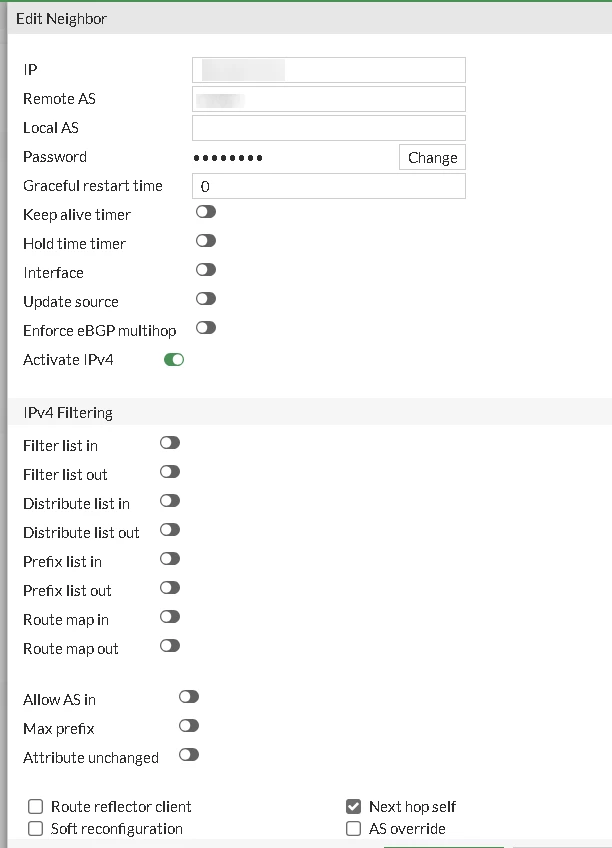

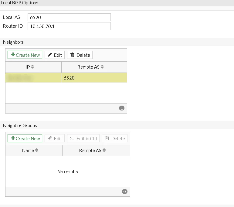

To fix this issue run the following commands:
config router bgp
    config neighbor
        edit "10.150.70.2"
            set next-hop-self enable
            set remote-as 6520
This can also be done on the GUI.
