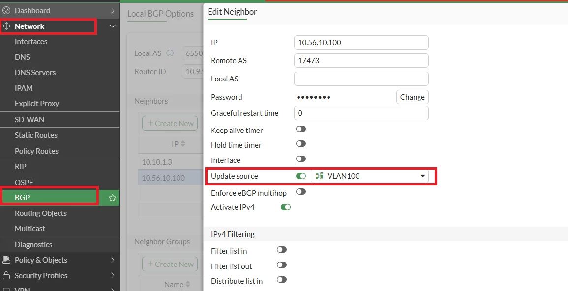

From GUI:
Navigate to Network -> BGP -> Neighbors -> Select and edit the neighbor -> Update source:
