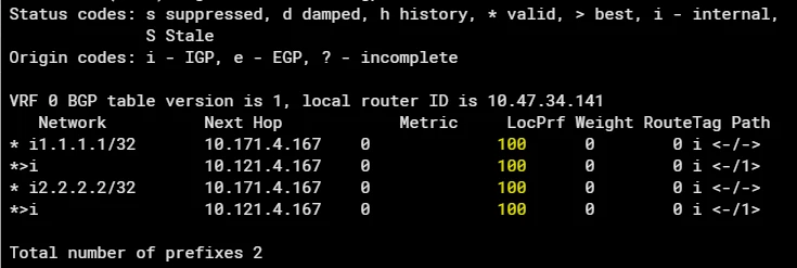

After the change, the routing table is still the same; the BGP attribute (local preference) was not getting enforced.
get router info routing-table bgp
Routing table for VRF=0
B 1.1.1.1/32 [200/0] via 10.121.4.167 (recursive is directly connected, port3), 00:00:49, [1/0]
B 2.2.2.2/32 [200/0] via 10.121.4.167 (recursive is directly connected, port3), 00:00:49, [1/0]
For the routing table to be updated, flushing the BGP neighborship is needed.

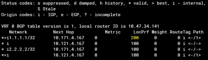

execute router clear bgp ip all --> This command will clear all the BGP peers.
Or:
execute router clear bgp ip all soft --> If the soft-reconfiguration option is enabled on the neighbor.
B 1.1.1.1/32 [200/0] via 10.171.4.167 (recursive is directly connected, port2), 00:00:06, [1/0]
B 2.2.2.2/32 [200/0] via 10.121.4.167 (recursive is directly connected, port3), 00:01:26, [1/0]
The local preference and routing table are updated after the BGP neighborship reset.
