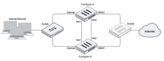

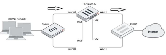

  • Disconnect (all cables) from the HA secondary cluster member, the FortiGate-B. (Secondary FortiGate with serial terminal FG-SERIALXXX_B.)
  • Leave only the FortiGate-A connected (Active FortiGate with serial terminal FG-SERIALXXX_A). This equipment will       remain operational to avoid service affectation. See Figure 1:
If the cables are not labeled, proceed to identify them to avoid confusion when reconnecting them later.

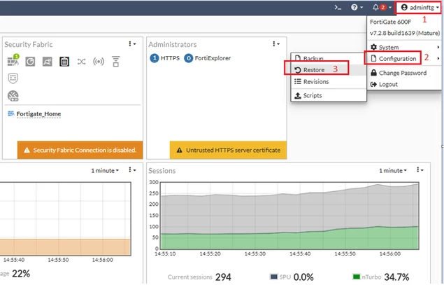

  • The backup made in the step 1 file should be located in the PC connected to the FortiGate-B. Choose and Load the Backup made in Step 1 to this FortiGate-B:
  • Once the backup is loaded, the FortiGate will reboot.

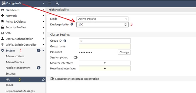

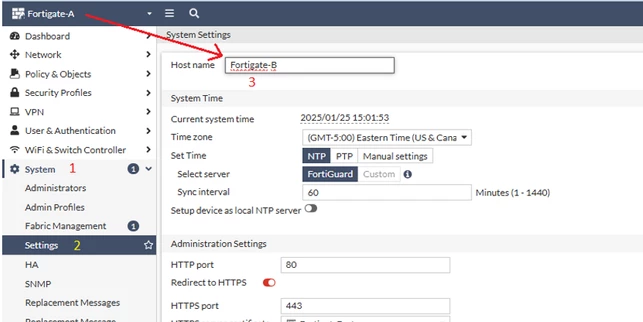

  • Log back into the GUI and Edit the Hostname and basic HA configuration as follows:
If there is no access to the secondary member through the GUI, these changes must be performed through the serial console connection, but first the configuration must be restored using a TFTP server. More information in the following technical document: Technical Tip: Restoring a config file from the CLI by using TFTP server
  • (Optional) Via CLI could be updated as follows:
config system global
    set hostname Fortigate-B
config system ha
    set priority 100       <- Set the value to 100, originally 200.
end                               <- Save the changes.
Check from the CLI that the changes have been accepted:
show full system global | grep hostname     <- FortiGate-B should be the hostname.
show full system ha | grep priority            <- 100 should be the Priority.
