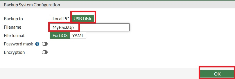

Before v7.4.9, it was possible to carry out a configuration backup in the following ways.
  1. Method 1 - Using the GUI: When doing so, it is necessary to enter the 'Filename' and no extension was required.
The backed up configuration file was possible to view using the following command:
execute usb-disk list
In this scenario:
FG6H0F-1 # execute usb-disk list
2026-06-23 01:50:44         729515      myconfig.conf
2026-06-22 01:06:32         334585      test 333.conf
2026-06-22 01:11:48         334585      test5555.conf

Since v7.4.10 to v7.4.12, it has been observed that once backed up, the config file was not listed under the output of the 'execute usb-disk list' command.

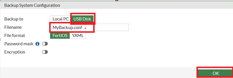

As a workaround, it is possible to action the following.
  1. In the GUI, add the '.conf' extension.
  1. In the CLI - Instead of using '.cfg', use '.conf'.
execute backup full-config usb config-%%date%%.conf
Note: This issue is not present in v7.6.x.
