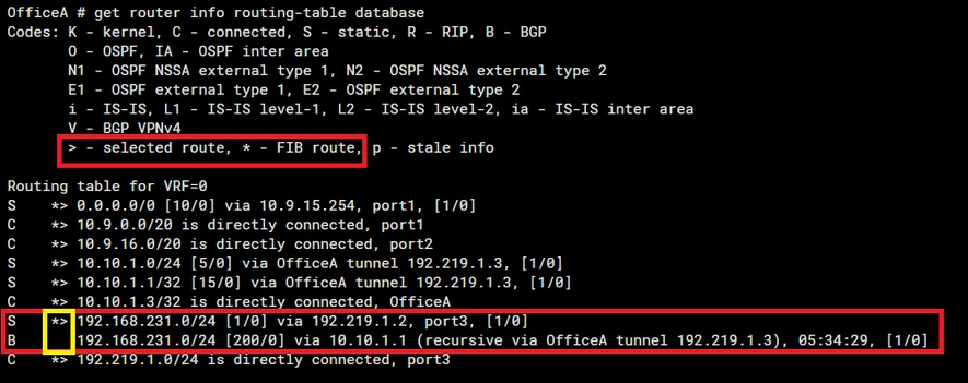

For instance, below is the output of the routing database where the Static route is selected as the best route and is added to the Forwarding Information Database(FIB):

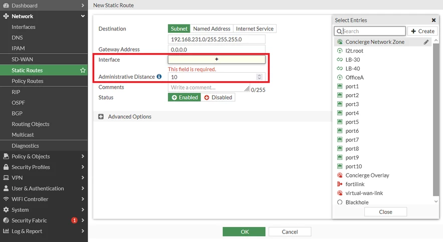

  • There could be a scenario where the design is to prioritize the Dynamic routing for a single subnet or IP.

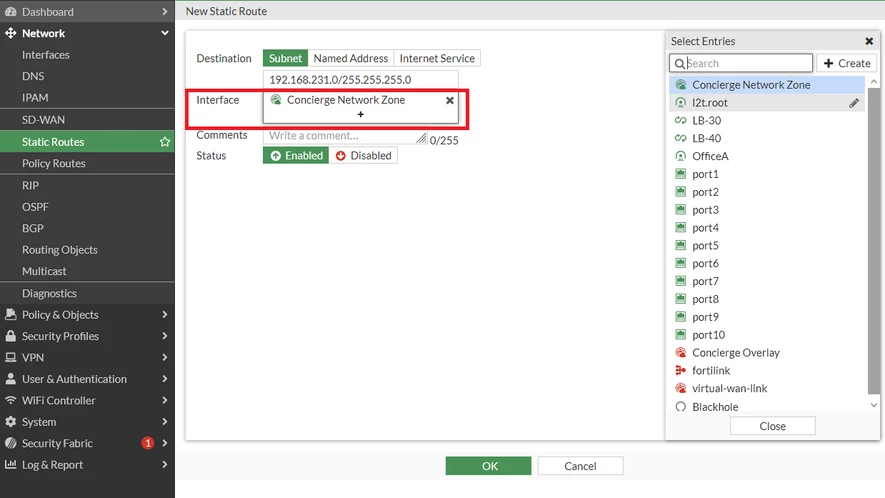

  • The issue arises when the Static route is over an SD-WAN interface, the GUI loses the option as soon as this interface is selected.
Before:
After:

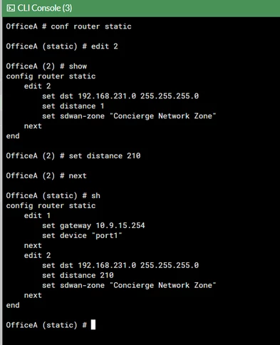

  • Although the GUI is missing this option, it is still possible to use the CLI to change. By default, a static route or the default route outgoing through an SD-WAN zone have an administrative distance of 1
config router static
    edit <Static Route ID>
        set dst <IP Subnet>
        set distance <Administrative Distance>
        set sdwan-zone "<SDWAN Zone>"

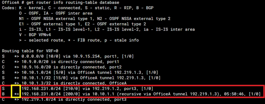

  • After changing the distance, it can be observed that the Dynamic BGP route takes precedence and is added to the Forwarding Information Database(FIB):
