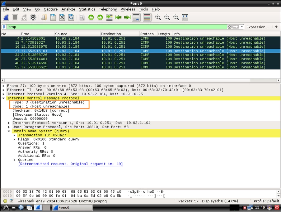

The lack of reply was not caused by the FortiGate, but FortiGate will generate a log entry like above if an ICMP Type 3 message with Code 0, 1, or 3 is seen on the network segment.

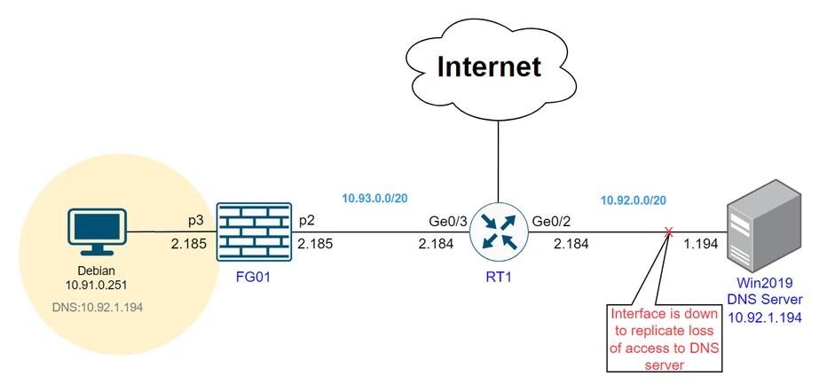

To explain this behaviour, check the following network diagram:
The Linux machine is using Windows 2019 Server as a DNS server (10.92.1.194).
To replicate the issue, let's assume the DNS server cannot be reached, but the router still has a route to it on its routing table pointing to Ge0/2. Due to the fact that the router cannot reach the DNS server, the ICMP message Destination unreachable (Host unreachable), ICMP Type 3 Code 0, will be generated by the router to the Linux machine.

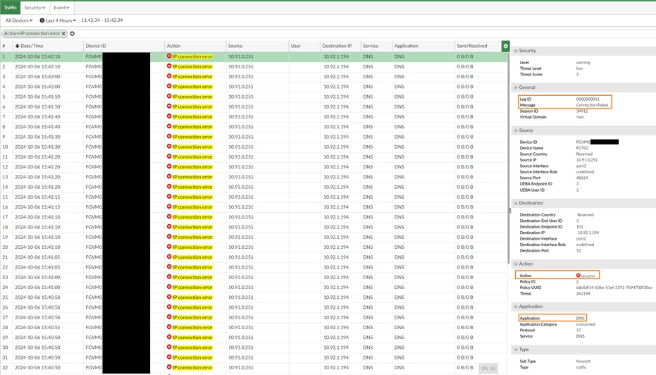

Once such an ICMP message reaches the FortiGate via port2, it will generate a log message similar to the message presented at the beginning of this article. FortiGate has FortiAnalyzer configured, so all log messages will be sent to FortiAnalyzer, as can be seen in the following image.
FortiGate is not responsible for the lack of communication between the DNS client and DNS server, but it will log a message ip-conn (Log ID 0000000011 DNS application) if an ICMP message Type3 with code 0, 1, or 3 reaches its interfaces.
