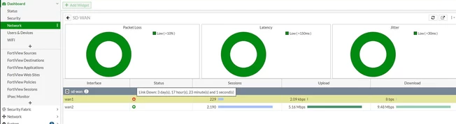

The WAN interface is showing as inactive, but the interface status appears up.

  1. When an SD-WAN member is shown as inactive, this is due to a failing health check. A simple way to check if this is failing is by running a sniffer filtered to the server being monitored.
  2. Verify by pinging the WAN1 gateway address to check reachability, or by checking the ARP for the gateway as per the commands below.
  3. Verify the interface status and speed settings.
  4. Check whether bypassing the firewall and connecting the ISP directly to the laptop works fine.
  5. Verify the routing table as below for the monitoring IP address and test with Ping options for reachability:
get router info routing-table details 0.0.0.0
Routing table for VRF=0
Routing entry for 0.0.0.0/0
Known via "static", distance 1, metric 0, best
14.98.4.77, via wan1 inactive distance 0
* 47.254.165.49, via wan2 distance 0
execute ping-options source 14.98.4.78
execute ping 14.98.4.77
PING 14.98.4.77 (14.98.4.77): 56 data bytes
^C
--- 14.98.4.77 ping statistics ---
5 packets transmitted, 0 packets received, 100% packet loss
IN-BNG1-P-FW01 # get system arp | grep wan1
IN-BNG1-P-FW01 #
