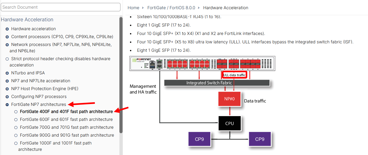

To verify if the FortiGate hardware model has ULL ports equipped, refer to Hardware Acceleration, navigate to the NP model that the FortiGate is equipped with, and verify the fast path architecture. The sample below illustrates the access to FortiGate 400F/401F fast path architecture:
