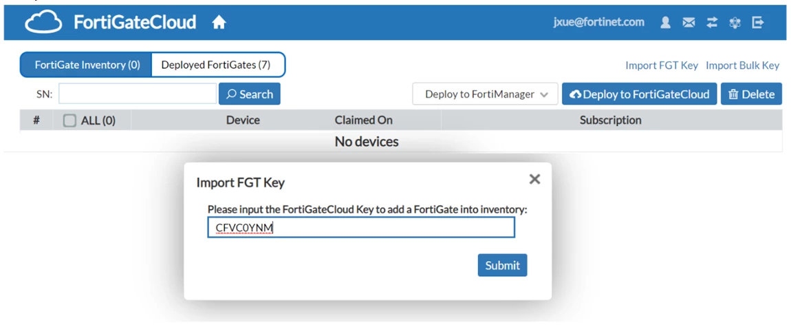

1) Add the FortiGate Cloud product key to the FortiGate Cloud portal so that the FortiGate serial number appears in the portal.

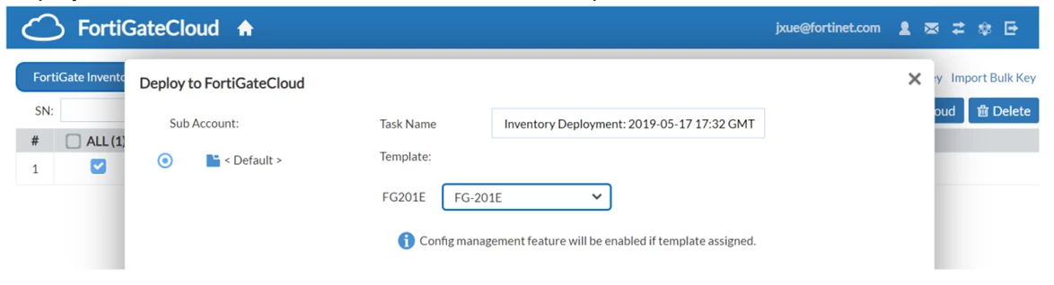

2) Set up a configuration template with the basic configuration in the FortiGate Cloud portal.
3) Deploy the FortiGate to FortiGate Cloud with that template.

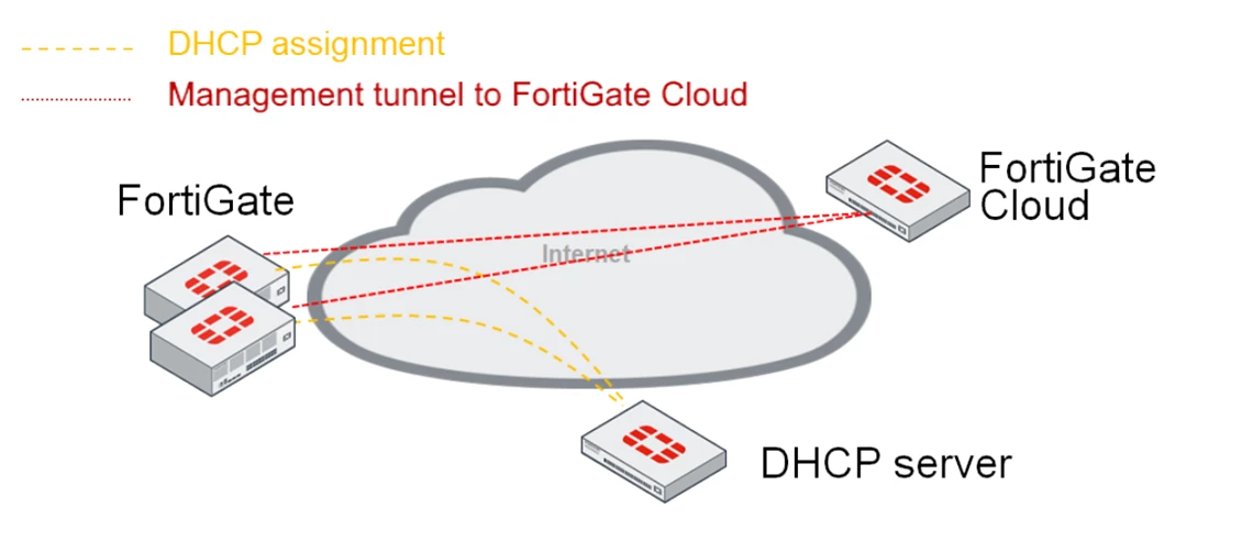

4) Ensure the FortiGate has an interface in default DHCP client mode and is connected to the ISP outlet.
5) Boot the FortiGate in factory reset. The FortiGate gets the DHCP lease so that it can access FortiGate Cloud in the Internet and join FortiGate Cloud.

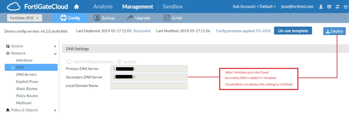

7) The FortiGate Cloud admin can change the template for different configuration requirements and then deploy the updated template to the FortiGate.
For example, add a secondary DNS to the template and deploy it to FortiGate.
