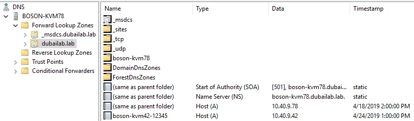

When user logs in from 10.40.9.42 to Domain controller 10.40.9.78, the DNS records is as follows:

FSSO DC Agent only records the first 15 characters in the workstation name which causes the domain resolution to fail.
This issue is directly related to the Windows/NetBIOS limitation that NetBIOS only supports up to 15 characters in the computer name. If FSSO support for longer host names is required, change the FSSO collector agent to Advanced AD Access Mode, as shown in the article Technical Tip: How to switch FSSO operation mode from Standard Mode to Advanced Mode.
