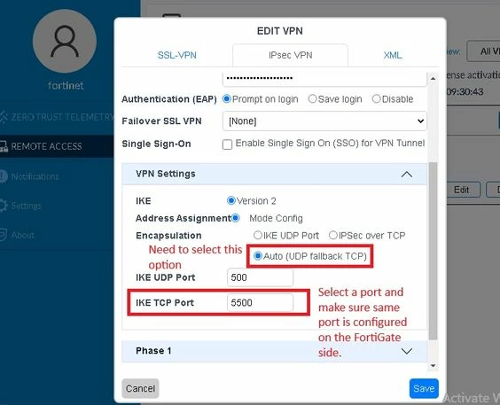

Related FortiClient configuration.
FortiGate configuration.

        set transport udp-fallback-tcp    <-- Select this option.

    set ike-tcp-port 5500

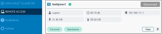

Tunnel is up with UDP 4500:
kvm81 # diagnose sniffer packet any ' port 500 or port 4500 or port 5500 ' 4 0 l
Using Original Sniffing Mode
interfaces=[any]
filters=[ port 500 or port 4500 or port 5500 ]
2026-02-26 23:17:23.208180 port2 in 10.3.2.150.59641 -> 10.55.3.193.4500: udp 842
2026-02-26 23:17:23.286816 port2 out 10.55.3.193.4500 -> 10.3.2.150.59641: udp 364
2026-02-26 23:17:23.301930 port2 in 10.3.2.150.59641 -> 10.55.3.193.4500: udp 552
2026-02-26 23:17:23.301951 port2 in 10.3.2.150.59641 -> 10.55.3.193.4500: udp 88

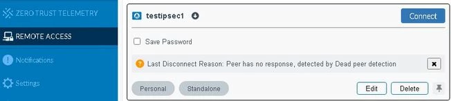

In the LAB setup, another FortiGate has been used to block UDP packets. Once UDP packets are blocked, the FortiGate keeps sending requests on UDP ports.
FortiGate is sending keepalives in IKE debugs.
ike V=root:0:ipsec_0:10: sent IKE msg (INFORMATIONAL_RESPONSE): 10.55.3.193:4500->10.3.2.150:59641, len=80, vrf=0, id=1d3827fc604e04cb/ef51edd37d9e4db3:00000037, oif=4
ike V=root:0:ipsec_0: NAT keep-alive 4 10.55.3.193->10.3.2.150:59641.
ike 0:ipsec_0:10: out FF
ike V=root:0:ipsec_0:10: sent IKE msg (keepalive): 10.55.3.193:4500->10.3.2.150:59641, len=1, vrf=0, id=ff00000000000000/8100000000000000, oif=4

FortiClient IPsec down.

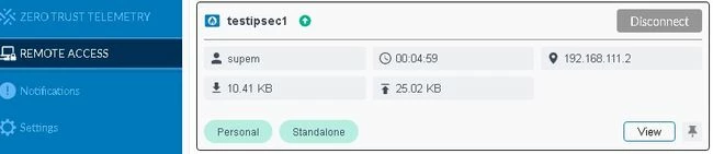

After selecting 'Connect' on FortiClient again, a new negotiation starts on TCP port 5500 as shown in the debug output below.
ike V=root:accepts ike tcp-transport(vd=0, vrf=0, intf=0:4, 10.55.3.193:5500->10.3.2.150:58518 sock=34 refcnt=2 ph1=(nil)) (1). <-- New negotiation with TCP port 5500.
ike V=root:0: comes 10.3.2.150:58518->10.55.3.193:5500,ifindex=4,vrf=0,len=838....
ike V=root:0: IKEv2 exchange=SA_INIT id=9702480b582147c9/0000000000000000 len=838
ike 0: in   9702480B582147C900000000000000002120220800000000000003462200019C020000440101000703000008030000020
Sniffer output with TCP negotiation commences.
2026-02-26 23:39:52.765478 port2 out 10.55.3.193.4500 -> 10.3.2.150.59641: udp 1
2026-02-26 23:40:02.765546 port2 out 10.55.3.193.4500 -> 10.3.2.150.59641: udp 1
2026-02-26 23:40:12.765517 port2 out 10.55.3.193.4500 -> 10.3.2.150.59641: udp 1
2026-02-26 23:40:21.594070 port2 in 10.3.2.150.58518 -> 10.55.3.193.5500: syn 309505874 <-- First Sync packet.
2026-02-26 23:40:21.594225 port2 out 10.55.3.193.5500 -> 10.3.2.150.58518: syn 3060518285 ack 309505875
2026-02-26 23:40:21.595270 port2 in 10.3.2.150.58518 -> 10.55.3.193.5500: ack 3060518286
2026-02-26 23:40:21.595404 port2 in 10.3.2.150.58518 -> 10.55.3.193.5500: psh 309505875 ack 3060518286
2026-02-26 23:40:21.595413 port2 out 10.55.3.193.5500 -> 10.3.2.150.58518: ack 309505881
2026-02-26 23:40:21.597153 port2 in 10.3.2.150.58518 -> 10.55.3.193.5500: psh 309505881 ack 3060518286
2026-02-26 23:40:21.597166 port2 out 10.55.3.193.5500 -> 10.3.2.150.58518: ack 309506725
FortiClient IPsec is up with TCP.
