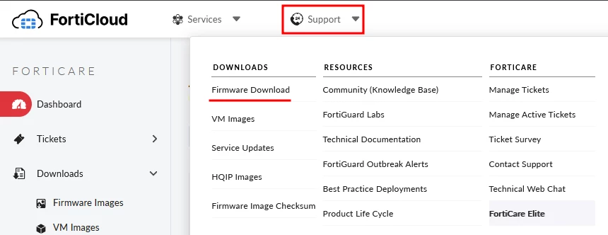

  1. Log in to the Fortinet Support portal.
  2. Select, 'Support' then Firmware Download.

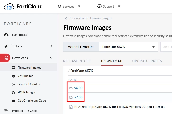

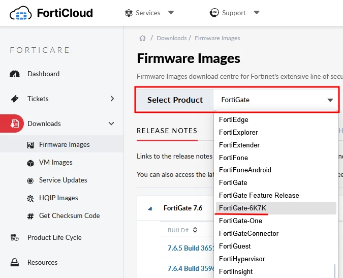

  1. In the drop list select FortiGate-6k7k product.
  1. Select 'Download' to access the firmware for 6kf, 7ke and 7kf.
