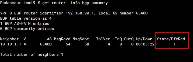

Step 1: Verify BGP neighbor status by running below command and confirm the status should be 'established' and prefix received should be greater than 0:
get router info bgp summary <----- Shows the BGP status of the router and all its neighbors, including: the AS, packet counters, and the length of time the neighbor has been up.
Example:
