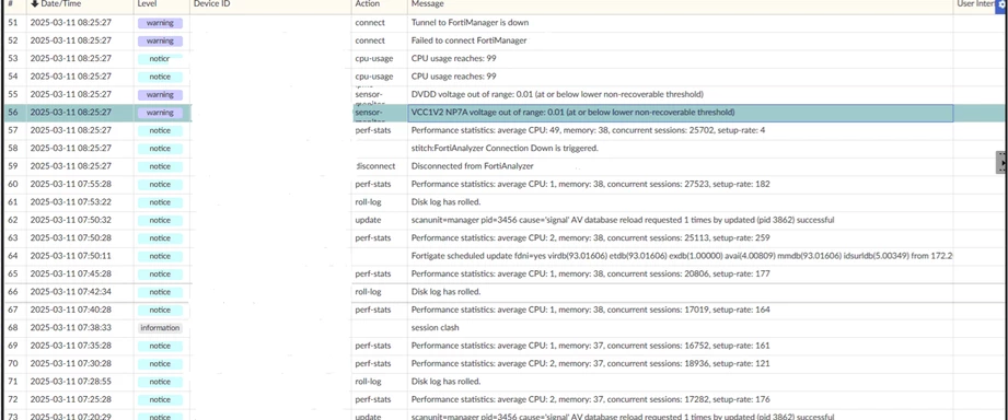

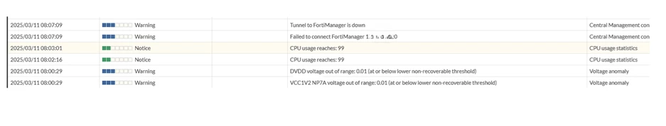

The following error may be seen on the logs:
Error Code: 12: High voltage and high temperature along with high temperature on NP7 chip(TB NP7X14Y5 temperature is too high: 217.00).
