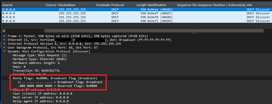

Some Routers provide a way to deliver the public IP address directly to the FortiGate by a bridge interface on the router, but some of them have issues with the DHCP service, which does not answer the clients if the BOOTP flag is defined as broadcast in the Discovery packet.
As the Router does not process it, the Offer packet is not sent, and the IP address assignment process stops, because the FortiGate does not have any reply from any DHCP Server.
To identify it, execute a packet capture from the WAN interface, looking for the bootp flag as highlighted in the image below:
Also check if there is no Offer packet from the DHCP Server.

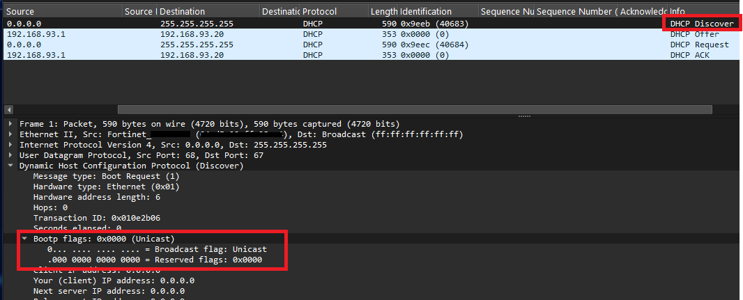

To fix it, change the option 'dhcp-broadcast-flag' under the WAN interface on the client device (FortiGate) to disable:
config system interface
    edit "wan"
         set dhcp-broadcast-flag disable
After this change, the Discovery packet should be like:
