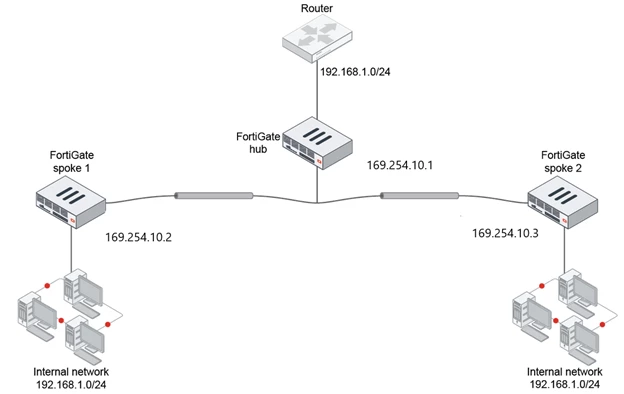

This article describes how to configure VXLAN over IPsec in Hub and Spoke topology, where there is single subnet in different locations and to keep communication between Spoke and HUB and between Spokes.
This will use single dynamic IPsec tunnel on HUB.
All spokes are connecting to HUB via this dynamic tunnel.
VXLAN interfaces (VTEP) will be bounded over this tunnel on HUB.
Because of this, this is applicable on the units that are running 6.4 and higher.
In this example, VXLAN will be configured in way, that it will allow configuration between all units.
It means that the spoke1 will be able to reach spoke2 internal network.
All traffic from spoke to spoke will be always routed via HUB.
Topology.

Verification.
Client1 behind spoke1 has IP address 192.168.1.100.
Client2 behind spoke2 has IP address 192.168.1.200.
As a result of the configuration, if everything is configured correctly, Client1 should be able to reach Client2.
The traffic will go from Spoke1 to HUB and to Spoke2.
