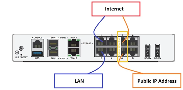

Imagine a scenario where a user has a normal LAN to Internet NATed access and at the same time has a second public IP address assigned to a Server that also needs firewall protection.
It is possible to try to accomplish this with the following scenario:
Technically, it is possible to configure FortiGate in this way without any errors, but although the access from the LAN to the Internet will work without any problems, the access from the LAN to the public IP address will not be possible.
In a FortiGate environment, several criteria are used to identify sessions, including VDOM, source IP + port, destination IP + port, etc.
The Virtual Wire Pair connects two interfaces as a transparent mode in a NAT mode environment.
So when in the same VDOM, the traffic goes through a Virtual Wire Pair and back into another interface (non-VWP), the FortiGate will not be able to understand if it should deal with it as transparent or NAT mode:
In the above scenario, the following would be seen upon trying to reach the Public IP address behind FortiGate (in this example, 192.168.x.x was used to simulate public addresses - 192.168.0.3 is the IP address inside the Virtual Wire Pair):
348.962579 port2 (LAN PORT) in 172.16.0.2 -> 192.168.0.3: icmp: echo request
348.981858 port4 (INTERNET) out 192.168.0.1 -> 192.168.0.3: icmp: echo request
348.982101 port5 (VIRTUAL WIRE OUTSIDE PORT) in 192.168.0.1 -> 192.168.0.3: icmp: echo request
348.982139 port3 (VIRTUAL WIRE INSIDE PORT) out 192.168.0.1 -> 192.168.0.3: icmp: echo request
348.983057 port3 (VIRTUAL WIRE INSIDE PORT) in 192.168.0.3 -> 192.168.0.1: icmp: echo reply
348.983062 port5 (VIRTUAL WIRE OUTSIDE PORT) out 192.168.0.3 -> 192.168.0.1: icmp: echo reply
348.983299 port4 (INTERNET) in 192.168.0.3 -> 192.168.0.1: icmp: echo reply***** Traffic stops here without being forwarded to the host on port2 (LAN)*****

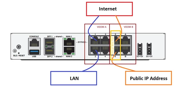

So the only way to make this scenario work is to logically separate the traffic into two logical entities (VDOMs):
5.392380 port2 (LAN PORT) in 172.16.0.2 -> 192.168.0.3: icmp: echo request
5.392464 port4 (INTERNET) out 192.168.0.1 -> 192.168.0.3: icmp: echo request
5.392888 port5 (VIRTUAL WIRE OUTSIDE PORT) in 192.168.0.1 -> 192.168.0.3: icmp: echo request
5.392919 port3 (VIRTUAL WIRE INSIDE PORT) out 192.168.0.1 -> 192.168.0.3: icmp: echo request
5.394303 port3 (VIRTUAL WIRE INSIDE PORT) in 192.168.0.3 -> 192.168.0.1: icmp: echo reply
5.394320 port5 (VIRTUAL WIRE OUTSIDE PORT) out 192.168.0.3 -> 192.168.0.1: icmp: echo reply
5.394592 port4 (INTERNET) in 192.168.0.3 -> 192.168.0.1: icmp: echo reply
5.394615 port2 (LAN PORT) out 192.168.0.3 -> 172.16.0.2: icmp: echo reply
Traffic will then be correctly delivered to port2 (LAN).
